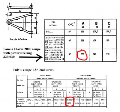

Lower arm of Flavia 2000 coupé
Unread post by Huib »
Does anybody have arms which are guaranteed to be from a Flavia 2000 coupé with power steering which we can buy or borrow to check the dimension and convert a Fulvia arm. Or if you have the tool to measure the arms can you confirm the Flavia arm is different from the Fulvia arm?
