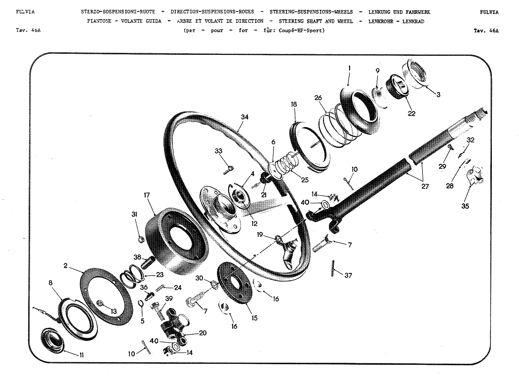

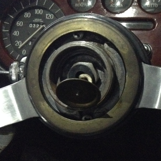

Problems removing steering wheel
Hello to all of you. Hope everyone had a nice Christmas / holiday season.
I am aware that this thread is not the newest one, but I was wondering if someone can help me with my Fulvia Coupe (1st series) steering wheel removal.
I have been trying to remove the thing for a couple of days now; so far with no success. I am afraid of braking something. However, my problem is not removing the actual steering wheel (at least not yet) as described in the previous posts in this thread, but removing a cover (bronze colour, but made of plastic) which sits on top of the screws holding the steering wheel. I have attached two pictures, one is from my spare parts manual (part "18") the other is an actual picture of my car. Is this part srewed in (can't see any screw head) or just clipped on top?
Any help / advice is welcome.
Thanks guys
Stefan

flavia1800
- Posts: 212
- Joined: 10 Apr 2009, 22:27
Re: Problems removing steering wheel
Hi Stefan,
The cover you see is shown as number 6 on the spare part manual sheet. You will have to remove it first.
To remove it, just gently pull it out of the steering wheel as far as you can, until there is no play anymore. The cover is connected by an electric wire of some 5 - 7 cm if I quite remember, and at the other end it's got a plug, so you must be able to unplug. By holding the lower insulation part of the wire with one hand ( you might be feeling the plug!) and with the other hand underneath the cover you can pull the cable out of his plug.
Once removed this cover, you unscrew the big nut holding the steering wheel. Then you turn the steering wheel upside down for the screws to loosen.as the nuts are underneath.
looks like, (but i might be mistaken) you remove the steering wheel as an assembly. the bronze contact ring should be attached by studs accessed from the backside.
i don't have mine to look at right now, but that's what it looks like from the drawing.

flavia1800
- Posts: 212
you right, but first of all you will need to have the bronze cover as shown in the picture removed.
