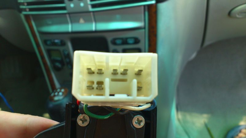

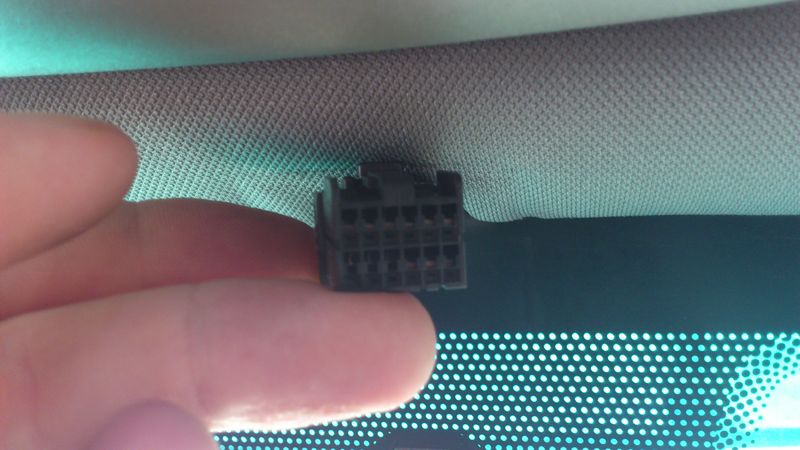

I bought photochromic rearview mirror that has a different connector (white) from my rearview mirror (black). Is it possible to connect it, and is there any difference since it is not the same connector. Is there some kind of scheme in order to connect it.

Yes it's possible, you have to identify from both sides all the connection with a tester.
You need to find a +12 volt with it's mass and the wire for reversing in order to activate the photocromic ( when you put the reverse gear the color of the glass must be change)
Also need to find wires for Fog Sensor and Rain Sensor if they're available on your car, I suggest to check them with the old rearview already mounted but the best thing would be to have the wiring diagram that you can find on the user manual or in the CLUB LYBRA website.
i hope this could explain some of your doubt despite my bad english
