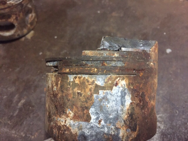

I had the block and pistons in solvents including WD40, diesel, automatic transmission fluid, hot water etc for many weeks and this did not separate the pistons or finally the liners. That is why I did what I did.
The engine had been siezed for 35 years so I expected a lot of damage. The liners were cemented together and no penetrating fluid would have helped. I tried heat and cold and vibration to try to
Here is a picture of the piston after I had to drill it from the liner. You can see the level of corrosion. The liner was no better.
The alternative to what I did was to throw the whole engine block away and get another one.
I have been working on engines of all levels of sophistication for 50 years so I realise what is not the correct process but in this case is the realistic one.

Dear Viiking,
seen the picture, I'm not a doctor but I define this work as therapeutic obstinacy ;-)

Very well, now that we have seen the condition of pistons, it is quite clear that the liners were not salvageable. :o There was some corrosion on my liners as well, where the piston rings had been sitting for some 30 years. It didn't look so worrying at all, but even though the liners were bored +0.6mm, some point of pitting was still visible on some liner, fortunately near bottom dead center, so they don't have any practical effect.
I would have mig-welded - very carefully, not to cause the aluminum surfaces to distort by melting - some seams inside the liners near where they meet the blocks. The weld shrinks the liner a bit and probably the heat will also help burning away the carbon deposits, that have glued the liners on their place. This method works well on stubborn bearings, when a press is not possible to be used. But obviously your method did the job, which is what matters!
I'm sure your liners did have gaskets, they are just so thin that they initially may look like dirt. They are also very difficult to be removed from the aluminum without scratching it (chemical removers didn't do anything). Patience is the key here...
