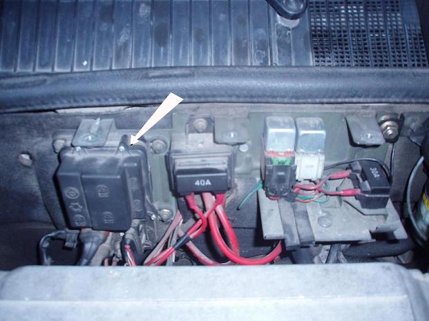

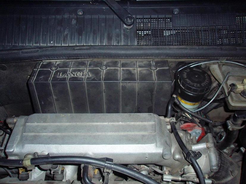

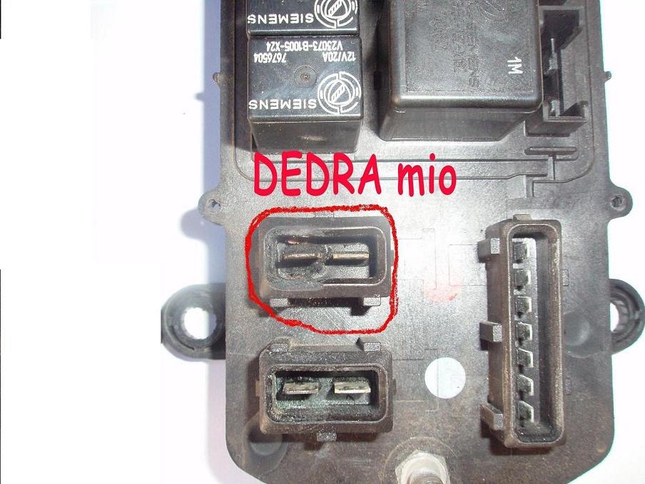

The climate problem can be in a unit that is in the engine compartment, this part has failed a lot, usually burned one of the connections (I attached photos). But first you'll have to do a load of gas.
