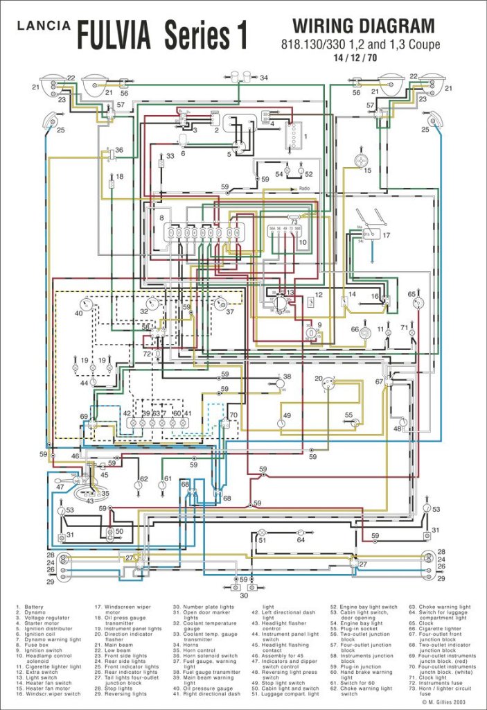

OK, let me try if I can download a nice (colored) wiring diagram for a series one. If It shows, then it worked...
[attachment=0]wiring_s1fulvia68_75.jpg[/attachment]

In fact the separate fuse (in the fuse drawer) feeds the klaxon relay with + (brown wire coming from number 6 fuse) and the ground signal comes from the contact in the steering column; the relay sends + via a yellow wire
this separate fuse also feeds the cigar lighter (and nothing else according to the wiring diagram)
This separate fuse is shown on the wiring diagram for 818 130 and 330 coupés and is given n°73 on the diagram, but forgoten in the list of things...

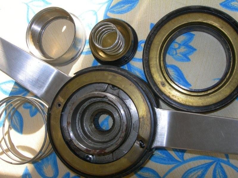

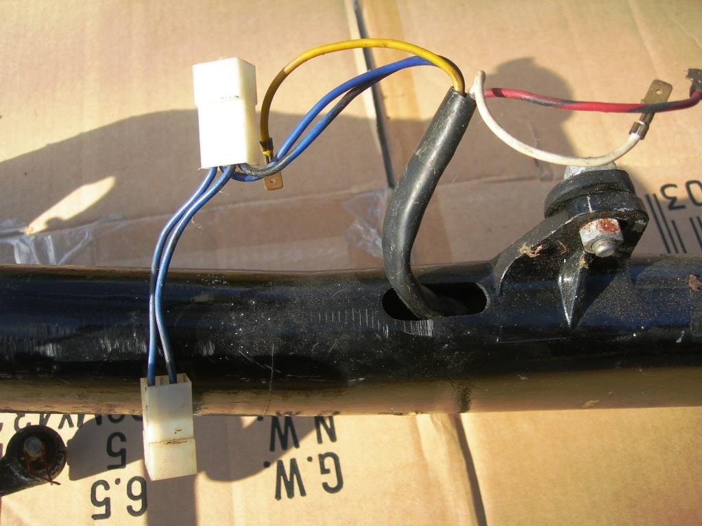

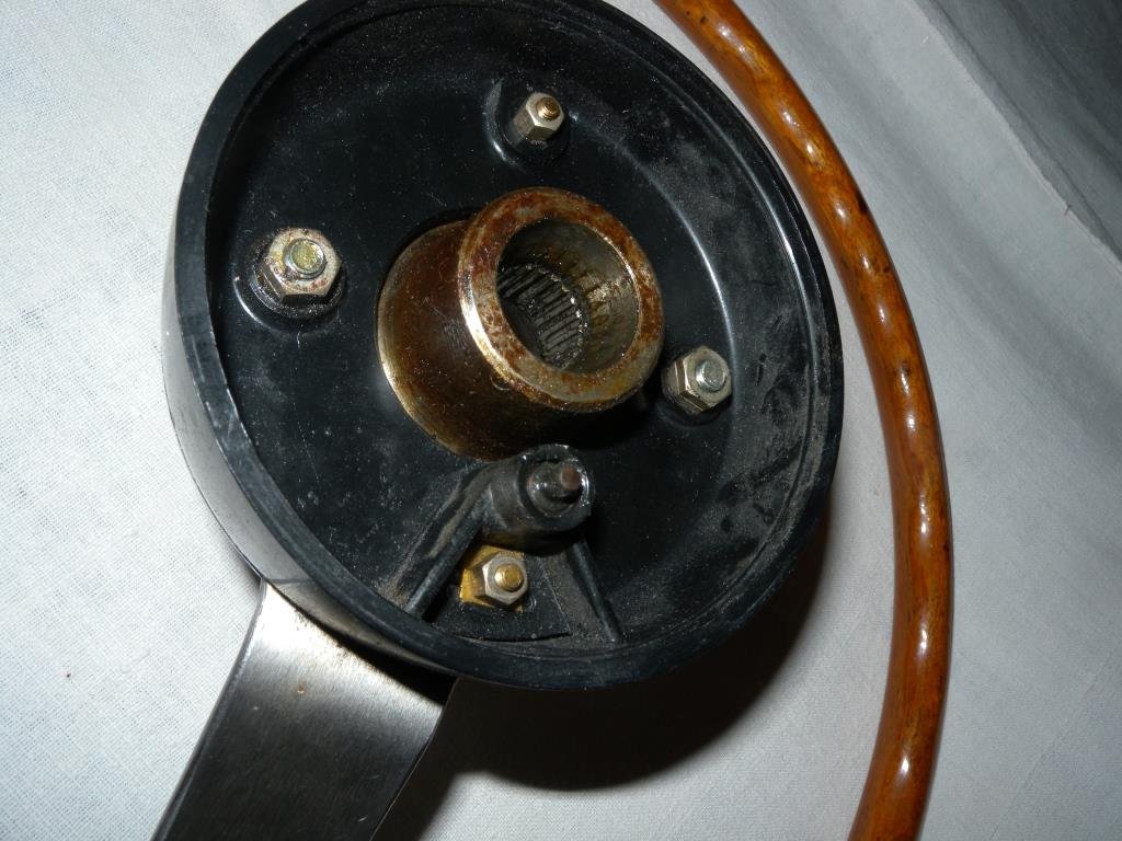

Please see pictures : you can see the reverse of the contacting parts :
About contact for the flash light is in the center, through a spring, the wire comes from the center of the column, and must be solded (en français "soudé") under the small copper plate; this wire should go to the main light contact on the dashboard : a piece of art ! (and a misery source....). I have made a new wiring with one relay for flash light, one for main beam, another for "low beam" so there is much less electricity inside the dash contact.
About the horn button : the signal coming from the "push button" in the center o the driving wheel is a "ground" signal : so you have to check that the wires in the steering column are OK and can drive a "ground" signal when pushing the button
The 2 horn contacts should be in "graphite" which is a charcoal material; you can find them in paper writing pencils for childern, and are fitted with small copper springs.

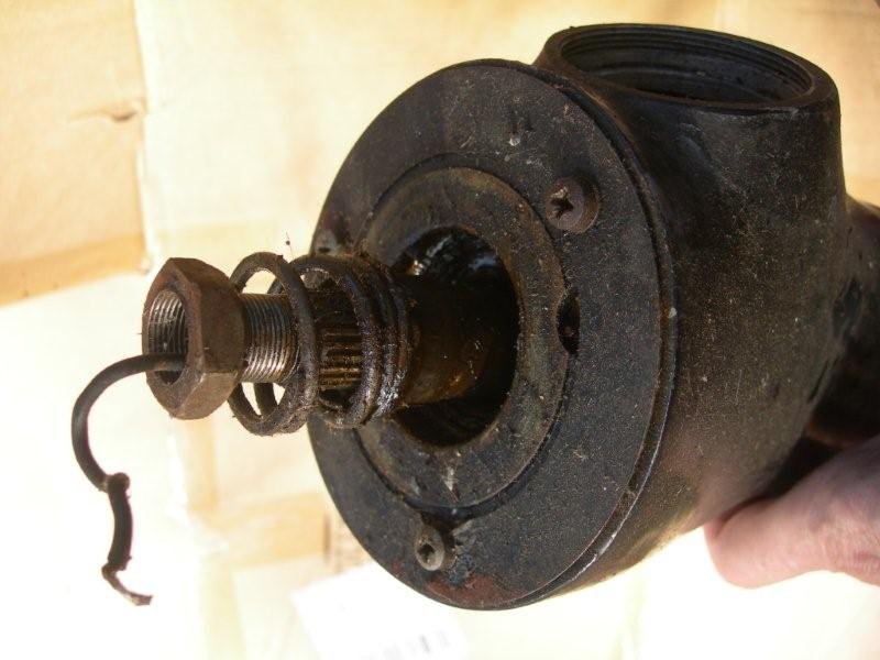

About klaxon, I missed to mention the rotating contact at the foot of the steering column : check if it is clean and oprrate in any position
