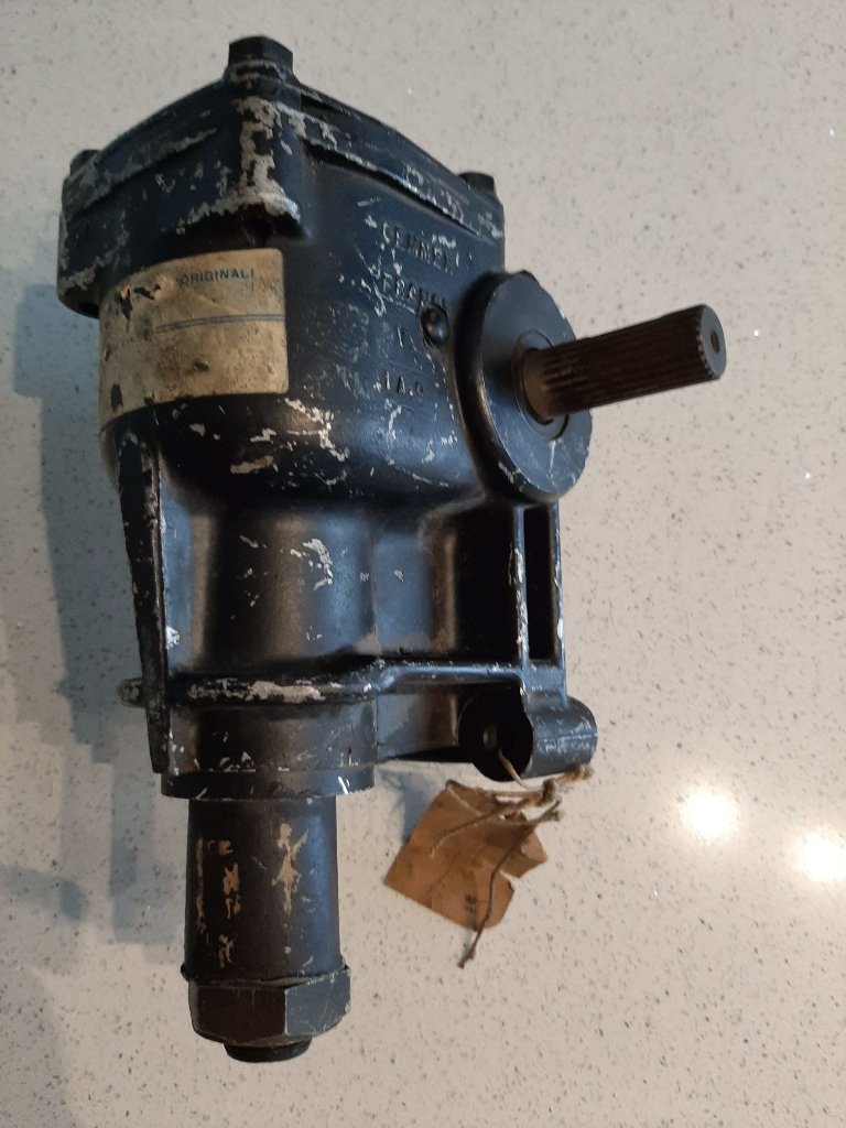

It turns out to be a LA9 box, which I believe is a HF box which has 3.25 turns lock to lock, vs. the standard LA10 4.25 turns. I think this might be a nice "upgrade", and as I am running skinny tires and without the HF camber changes it should not be too heavy. Time will tell.

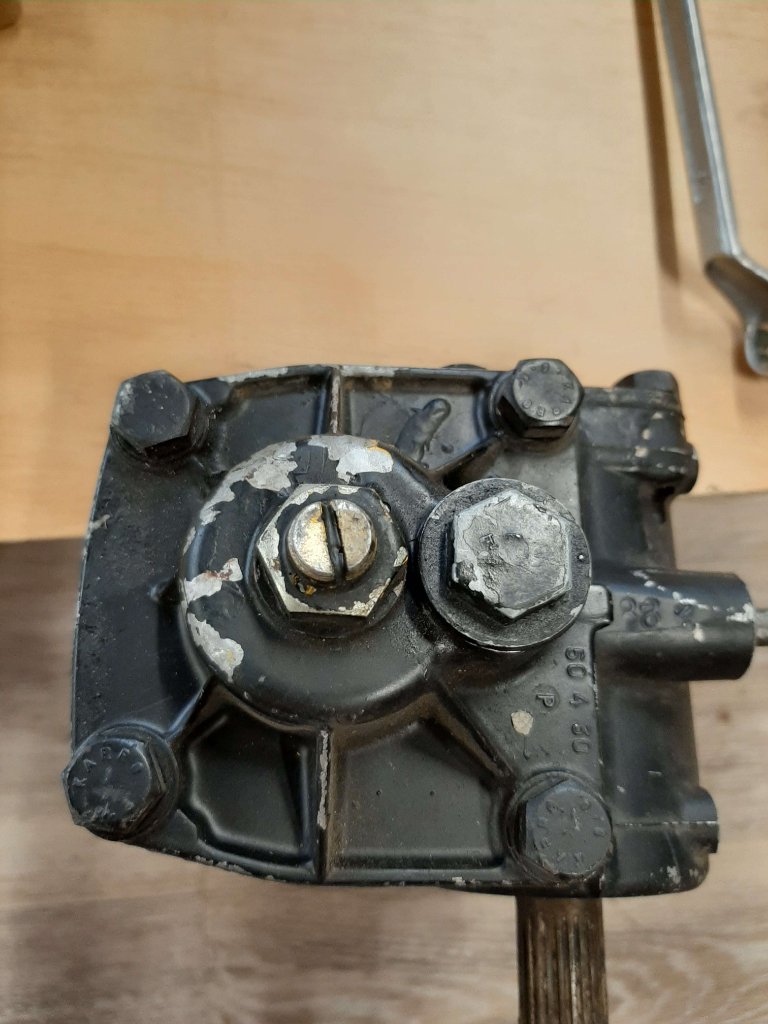

Being a "new" 40+ year old part, I had some reservations that the bearings etc. would be corroded inside. So decided to open it, rather than to just replace the oil seals. I really struggled to get the top nut and adjustment screw seperated as the whole lot appears to be painted black after assembly. A bit of heat did the trick. Luckily it turns out to be assembled with some oil (not filled) and the bearings and surfaces are perfect.
A few observations after opening the box:

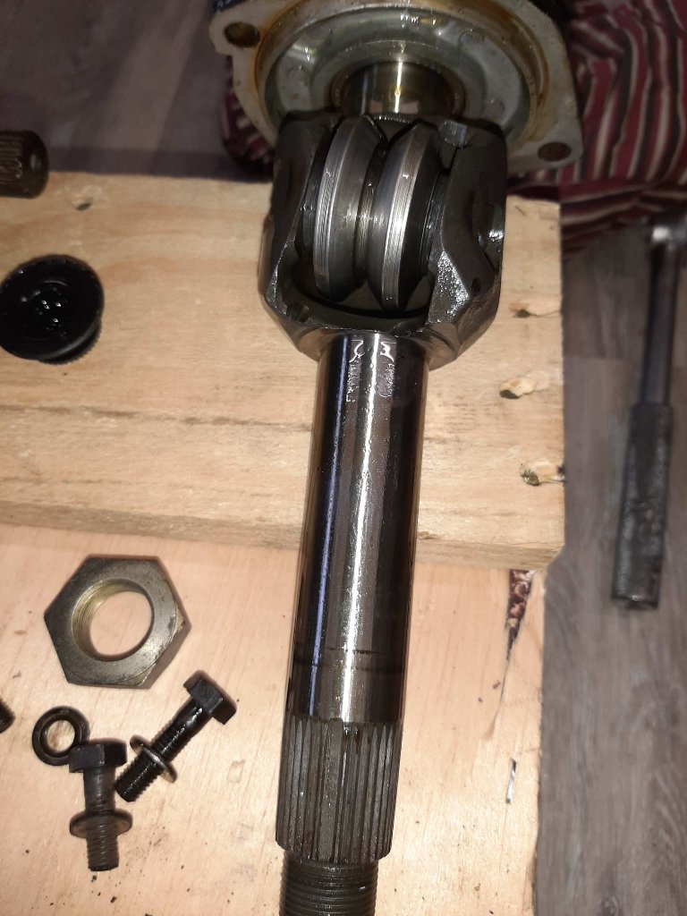

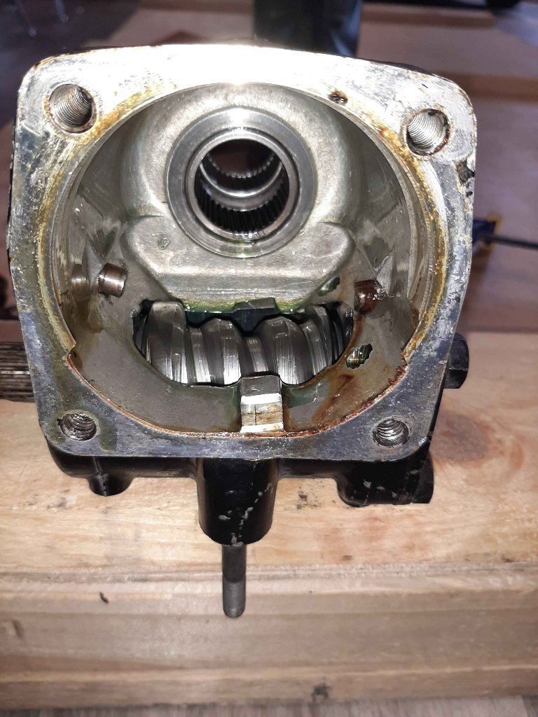

- I was surprised at how tight the horizontal shaft is shimmed (even with the vertical main shaft removed). You can turn it by hand, but it is pretty stiff. It will probably loosen up with use. I decided to oil this properly, but not to take the side cover of to disturb the paper gaskets and shims that are in there. A bit of a lesson for when I reassemble a box in the future that this can be slightly tighter.
- The setting screw was locked (and painted in place) pretty tightly as well. You can feel quite a bit of pressure around the middle point when you rotate it by hand. Probably also a fraction tighter than I would have set it but, again, I think it will free up a bit with use.
- the HF box appears, from memory when having the 1.3 box apart, to have a much smaller "knuckle" and roller, and a wider opening inside or more material removed inside, as it is much easier to align/ get the main shaft in position when reassembling.
Anyway, all that is left now is to swap it out and test it.
I have attached some pics, the green is a little oil I added.

The secret is indeed in the shimming of the worm. Any micro play there translates into milli play on the wheels.
There are shims between the front bearing and the housing and as you say under the rear cover. Under the rear cover is a stack of metal and paper shims which double up as gaskets. The paper shims don't survive disassemnly and washing. We make new ones from ultra thin plastic sheet.
