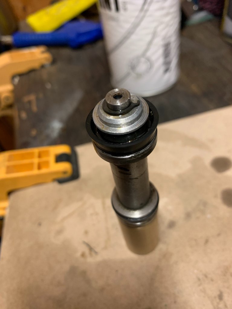

Re: Bleeding super duplex part. 3
Is it an idea to post pictures here of the inner parts?
Yes of course I will try and do it later today.

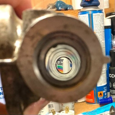

I got the same idea remembering that you both told be to check that the small plunger in front should move - it did when newly greased but now it is completely stuck.
I have just cleaned everything again and now the it slides easily.
I will try and attach pictures of the components but I guess it is back to the garage and try again - now without any grease at all.[attachment=0]IMG_1420.JPEG[/attachment][attachment=1]IMG_1419.JPEG[/attachment]

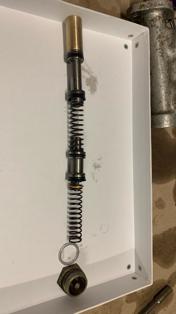

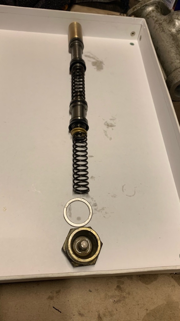

Can you put the plungers and springs flat on the table in the order you got them out of the cilinder? And take a pic of course.
Best try. Had to resize pictures.
[attachment=0]EDBE6245-49DA-4434-99D2-193DF5A13E78.jpeg[/attachment][attachment=1]A14EB23A-8198-4E23-A9DE-25356F94D4BA.jpeg[/attachment]
