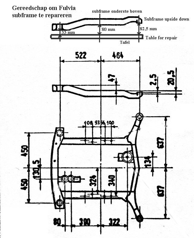

The off set at the rear is 2,5 mm.
If my name would have been Sherlock Holmes my story would be:
In 1963 the responsible engineer made an entirely correct drawing for the Fulvia berlina 1C. That sub-frame was like the Flavia. It does not have the out riggers.
A year later the 2C appeared. Its sub-frame did have the outriggers. A trainee was told to modify the drawing of the sub-frame of the earlier 1C into the drawing of the later sub-frame. The trainee did not have the experience to understand what the important measurements are for the purpose the drawing was put in the DT for. He put the figures he was given in correctly but related them in the wrong way.
Huib

I found the drawing I made to construct a table for repairing a sub frame. The table was much in such a way that the sub frame can be clamped onto it the right way up or upside down.

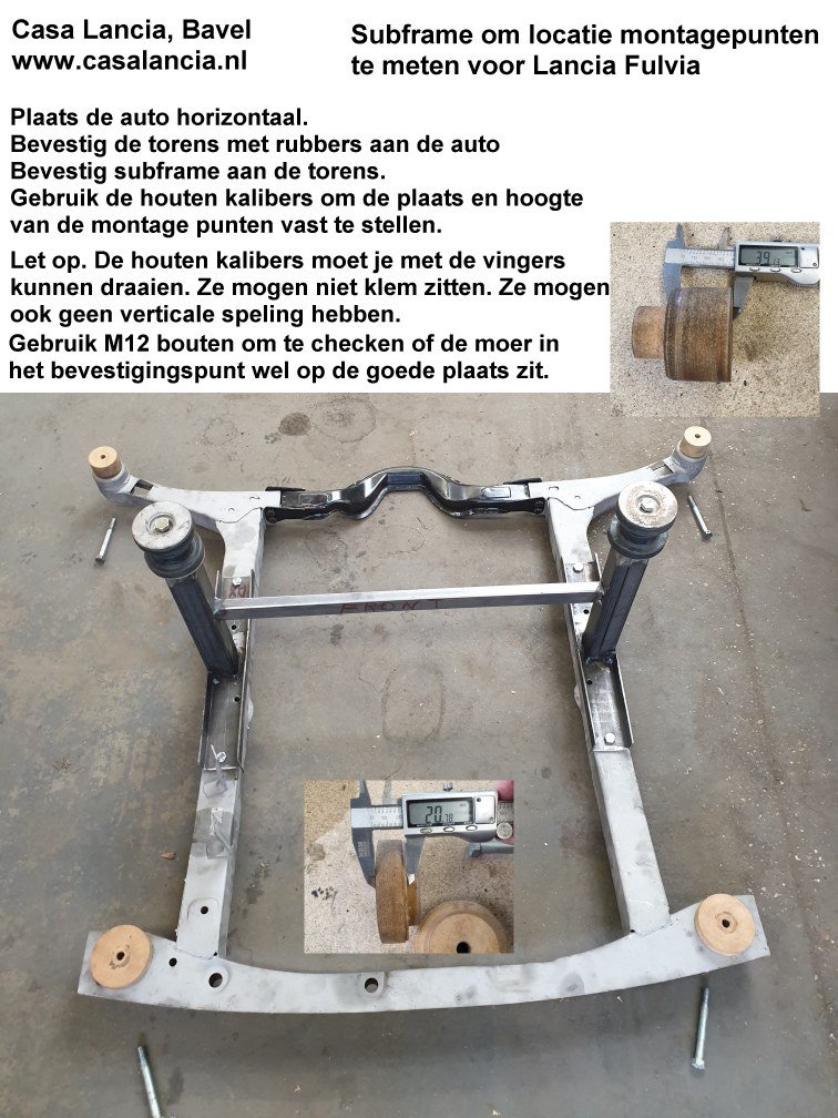

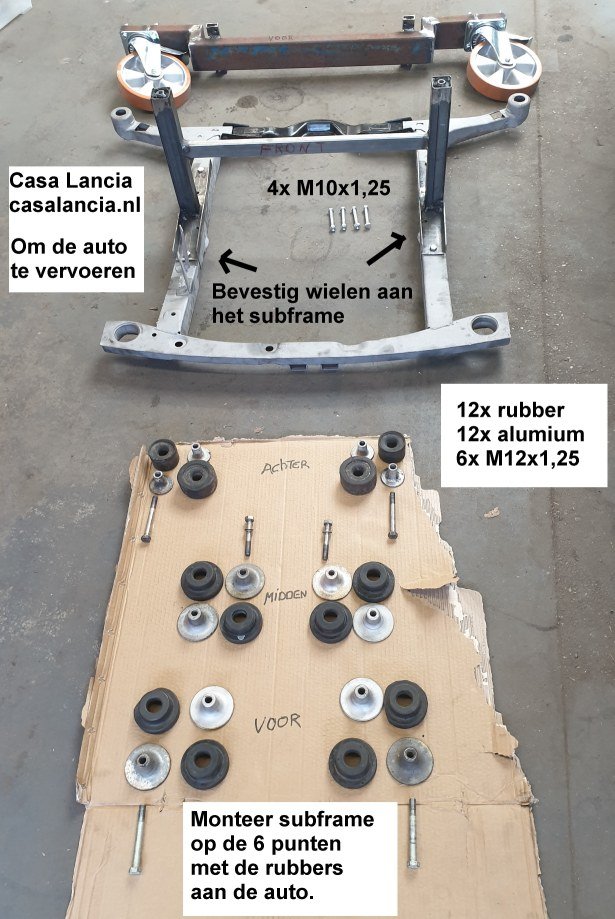

Attached photo's of the sub frame we use for measuring and for transport.

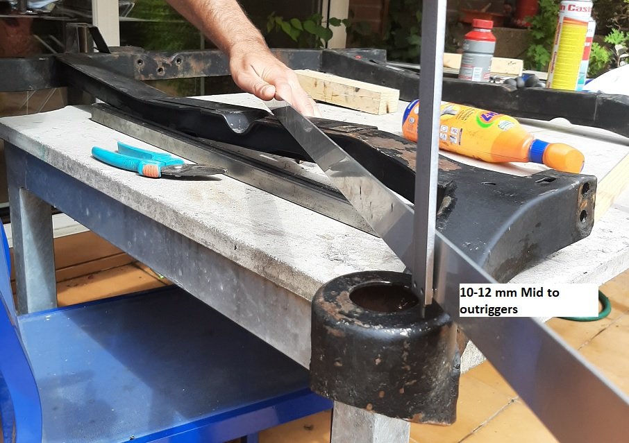

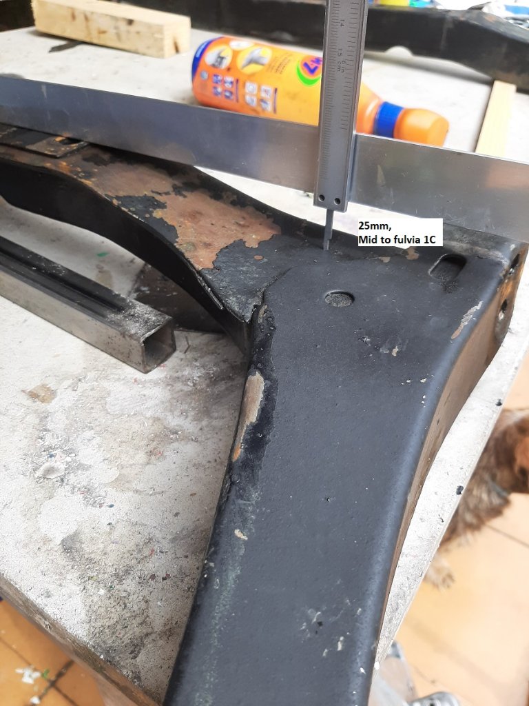

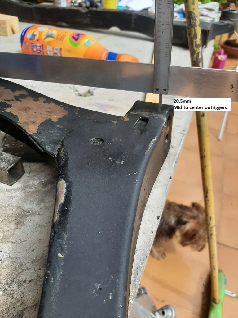

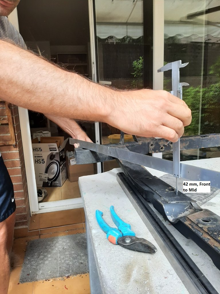

I'm still a bit unclear so I figured I'll provide You my own measurements, maybe they help.
See the pictures below.

Fantastic information Huib, I take my frame is badly bent. I do need a jig like yours. Is it normal to find them so much out of wack?

The sections of the sub frame can be bent, curved, twisted, warped, torn etc.. Even all at the same time
Measuring the sub frame is thus not easy. According to my piano tuner who also restores grand piano's and according to myself it is worth the effort of doing the job correctly to the mm
Get some spirit levels. One long enough so you can put it from one inner wheel arch to the other so you can use it on the car too and a digital one of average length with magnetic base. Also get some steel square bar lengths which you can turn into spirit levels buy clamping the magnetic spirit level onto it.
Get a Messfix like https://eshop.wurth.nl/Messfix-voor-aut ... nl/NL/EUR/ The thing is made from aluminium. You need a helper to hold the spirit level on top.
Build a strong table with adjustable legs so you can set it perfectly level.
Construct two extra brackets with 4 10 mm holes on the top, the length of the mounting flange for the alloy towers and an height of 80mm. Make sure you can put the sub frame on top up as well as top down.
Start putting the sub frame on the table without bolting it to the table. Just observe and measure. Then bolt it to the two brackets. Observe and measure. Turn it upside town. Measure again. Take a few days to play with the toys and ley it sink in before you start cutting and welding,
Look at the mounting base of the towers. It is not in contact with the sub frame over the full length.

The way of measuring I see on the pictures is very recognizable. That is how we started. It is not accurate enough. The table we built is modular and now in use to build up a complete subframe. I can't take any pictures. It is as I described. It also includes a removable clamp for keeping the M10 holes for the rear cross member in place when doing surgery.
Every case is different. In general I woulds say, if it is bent through an accident you may have to do surgery. Most of the time bending is done easily with the standard hydraulic tools for accident repair. It stays in shape I assume. I have not tested what happens after 50 years. My successor has to do that.
We put in the rear cross member when measuring. We are fortunate enough to have some sub frames from cars which were never driven fast and never had an accident. Those sub frames are unsuspected and have the correct dimensions. Those happen to be from 2C's and one from a 1974 1300 coupé with very low mileage. Its only abuse is that it was not used. There is a lot of work (even the gearbox has rusted inside because the oil had dripped to the bottom over time) but no work related to mechanical deformation.
The sub frame and the body form a box which should give enough strength for normal use whatever that may be. The body part of the box is stronger than the sub frame. Make sure it is. Put the body shell on 4 axle stands where the jack supports are. Move the front of the fenders up and down with the doors open and see if it flexes.

the description of your jig is very accurate, thanks. Later today at latest tomorrow I'll post a picture of the jig I'm building. The primary reason for building the jig is indeed get the measurement right. I do recognize that my measurment cannot be very accurate. I would not trust them to ensure that the frame is straight to the mm, but it makes evident that right now is badly bent.
