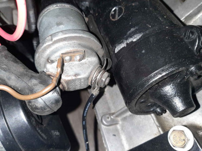

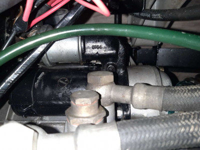

Unread post by lancia7550 »
Pics of Bosch starter

Unread post by bmarler »
many times it's the starter bendix sticking in the engaged position. this may hold on the contact for the motor to keep spinning.
while it's possible the ignition switch is holding on, i think it's much more likely the problem is within the starter itself. sometimes simply removing the starter, disassemble and clean, possibly new bendix (look for burrs on this assembly) , will cure the problem.
while you have the starter out on the bench, look at the large contact that makes the connection when the solenoid is engaged. sometimes the contact can weld itself together and make the starter hold on. usually, this contact is a copper stud, and can be pushed out and rotated so a more un-worn out portion of the contact can be used. the contact can also be filed to remove any burrs.
my description may not exactly be clear, but you'll see what i mean when you have it apart.
